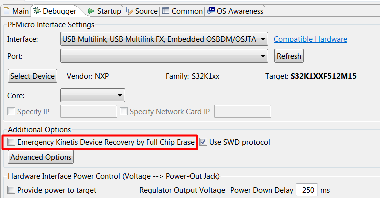

Did you try the Emergency Kinetis Device Recovery option?

Thanks so much for your reply. I already tried that, but no success.
I tried to investigate the issue using j-link. I found that the board is "secure" and "mass erase" is enabled. So theoretically, it can be erased to unsecure. But in practice, it does not.
I also tried to flash the binary or read memory (SRAM) using j-link. But j-link keeps reporting error:
"Protection bytes in flash at addr. 0x400 - 0x40F indicate that readout protection is set and mass erase is disabled."
"Timeout while halting CPU"
When I execute "unlock kinetis", j-link reports OK. But the above error persists when I try other commands.

What did you actually load to the chip?
Have you read this thread and this document?
Although it is Kinetis, it should be similar.
But if the mass erase is really disabled (MEEN = 0b10), then it is probably bricked.
