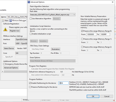

For my application, I need to read and write certain data from the s32k144 EEEPROM. I'm using EEEPROM code without SDK.
Configuration on debugger advanced option.
I just manually modified these lines in the S32K144_64_flash.ld file.
I'm just trying to write to EEEPROM using the code below.

danielmartynek
Hi @Yuvashree,
The MCU should be partitioned only once in the lifetime of the device.
It can be done using the PE Micro debugger as you showed.
Please check the SIM_FCFG1[DEPART] register to confirm the partitioning.
If you decide to do it in the code, first read the DEPART register, and lauch the command only if the NVM has not been partitioned yet.
Also, the command must be launched from SRAM.
