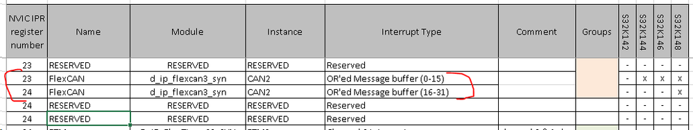

I want to receive a CANFD message using interrupts.But,I don't know the difference between CAN0_ORed_0_15_MB_IRQHandler and CAN0_ORed_16_31_MB_IRQHandler。
Then, I want to receive CANFD data as a register。Excuse me, how should I operate the register?

You have a pointer to received data – it’s type flexcan_msgbuff_t:
typedef struct {
104  uint32_t cs;
105  uint32_t msgId;
106  uint8_t data[64];
107  uint8_t dataLen;
108 } flexcan_msgbuff_t;
There are two interrupt vectors - one for message buffers 0-15 and second for message buffers 16-31.
