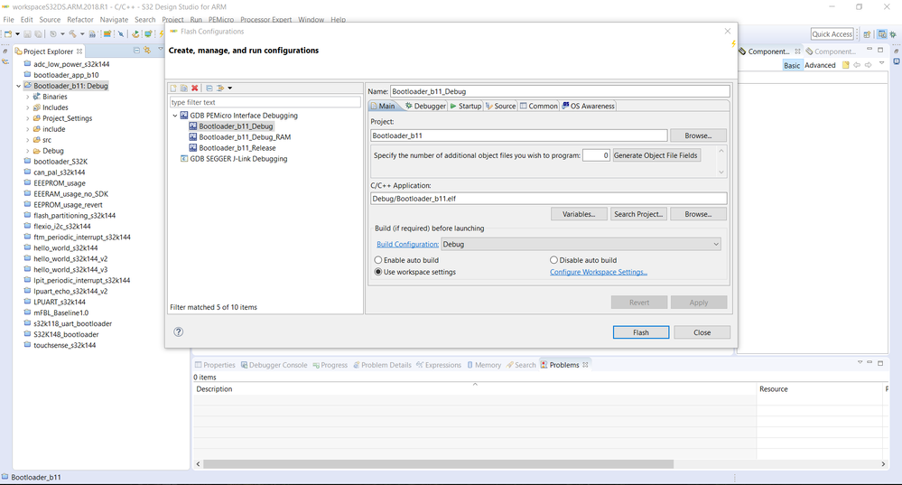

I) Step 1 : to flash Bootloader (BootLoader_b10.elf) to S32K144 (through USB micro connector)

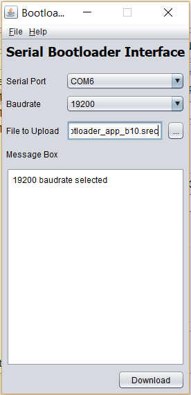

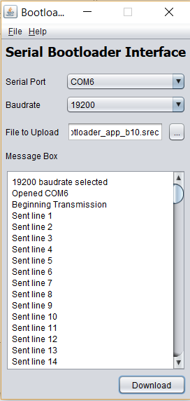

II) Step 2 : Bootloader will wait in 10 seconds for you click "download" user application 'bootloader_app_b10.srec' file through Serial_Bootloader_Interface.jar tool (Select Baudrate = 19200). If not, Bootloader will run forever in for-loop (user application is not downloaded into S32K144)

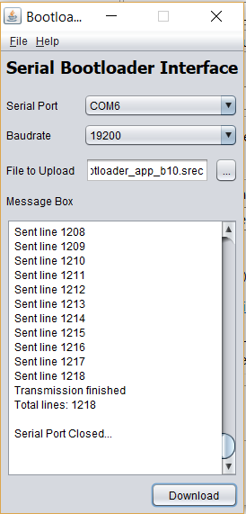

Note1 : After User Application is downloaded into S32K144, Bootloader will automatically jump to user application (RED LED and GREEN LED blink alternately)

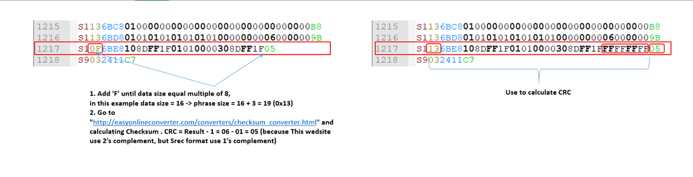

Note2 : If you re-build User Application in User Application project, you need to modify a little srec file (bootloader_app_b10\Debug\bootloader_app_b10.srec)

hi ,can  you help me  ,I do this  ,but  the  app cannot  be loader .  I  donot konw  How to  edit  the  srec file ?    can you   share  youre  e-mail ?

I would like to add the note. It is better to use some tools for SREC alignment for huge application projects.
The srec_cat tool can be used for this purpose:
