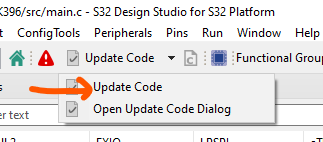

NamLee
Hi tkubincova,
I think your generate code way is incorrect. Basically we just need to hit "Update code" after doing all configurations.
I think there's no different with the LIN example.
Please help me to try this.

tkubincova
the Update Code only generates the RTD files in my case, not the LIN stack files, specifically these:
#include "lin_stack_cfg.h"
#include "lin_common_api.h"
#include "lin_commontl_api.h"
#include "lin_diagnostic_service.h"
so the code does not compile. How do I get these source files? What packages do I need to have installed? (I already have the packages mentioned in daniel's reply)

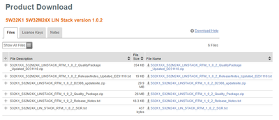

NamLee
Hi tkubincova,
I mostly support about RTD and not familiar with LIN stack, but did you try to find the LIN stack from NXP?
E.g this RTM release, please consider to follow this.
Design : Product Download : Files (flexnetoperations.com)
Thank you,
Nam.
