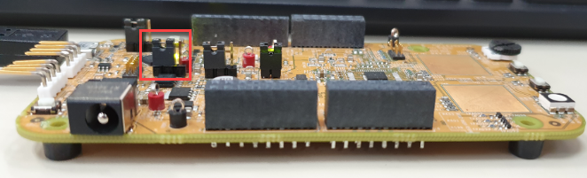

hallo,
I am using S32K118EVB MCU. I connected usb to pc and other port to microcontroller. Power is not supplying to it. By default jumper J107 are in 1-2 position.But I have to configure 2-3 position. How to install J107 in 2-3 position?
Kind regards,
Bhanu
Tags (3)
2,218 Views
victorjimenez
Hello Bhanu,
You are correct, if you want to power your board through an USB cable you need to connnect J107 to 2-3. To do this you need to put the jumper as shown in the below image.
