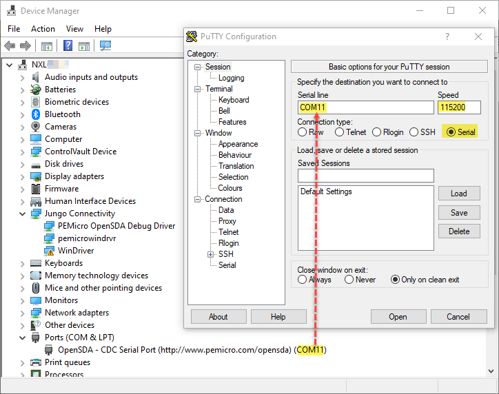

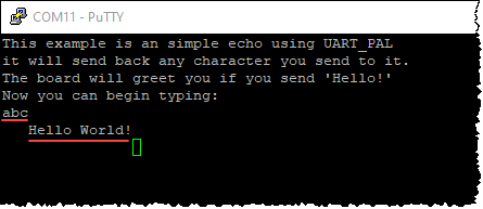

I am using the same setting with yours, and PuTTY is able to send back any character I send to it.

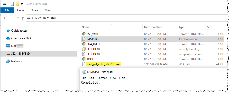

1. Debug lpit_periodic_interrupt_s32k118 example to check whether the board is able to run after disconnected and connected again.
2. Copied and pasted the uart_pal_echo_s32k118.srec to the S32K118EVB drive. The LASTSTAT.txt shows that it was Completed.
3. Disconnected and connected the S32K118EVB board again.
4. Configure the PuTTY working at Serial type 115200
5. Press Ctrl+J after each character input
Robin

Robin_Shen
Robin
