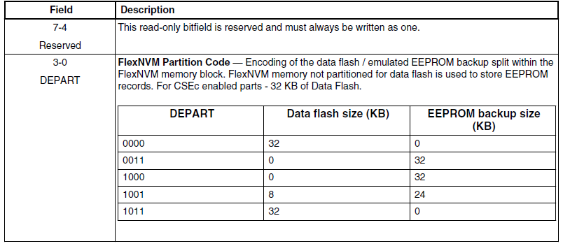

Hello ,
i need urgent support for the following question ,
can i customize / partition the FlexNVM partition for S32K118 Controller , as you see below is the configuration for that partition , but i need 24 KB Data flash and 8KB EEPROM backup size .
is that possible , i can see still three values missed in the configuration   ?
1,952 Views
danielmartynek
Hello Ibrahim,
The EEPROM backup size (S32K118) can be 0KB, 24KB or 32KB as specified in the RM.
You may refer to Flex Memory Endurance Calculator.
