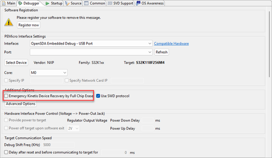

The simplest operation is to use the debugger to execute the mass erase command to erase the MCU partition (note that CSEc was not enabled in the previous partitioning operation, otherwise the chip may be permanently locked after the mass erase is executed).
For PE&Micro
For J-link(j-link commander)
Enter “unlock kinetis” in the J-Link Commander.
