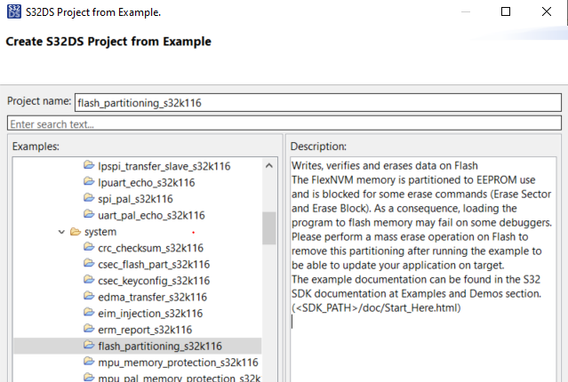

1.You can find the demo "flash_partitioning_s32k116" in S32DS

As you mentioned the default example which I can use, but even the default example does not run perfectly on the S32K116 board. I am facing an issue with the default ISR, meaning when I pause the running application on S32 Design Studio for debugging, it redirects to the default ISR. How can I resolve this issue?
2,595 Views
Senlent
Hi@Dishank
You will see such note in the description of the demo "flash_partitioning_s32k116"
so please perform a mass erase operation on flash first and then try again.
