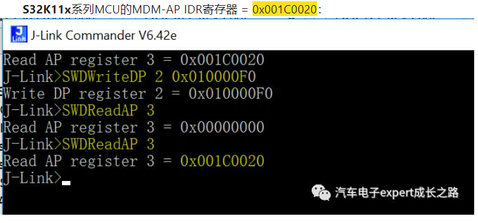

Senlent
Hi@muhammetkalayci
1.please try to use J-LINK to read the register of MDM_AP
for example:
According to AN4507 :https://www.nxp.com/search?keyword=AN4507&start=0
"If  the user disables mass erase with no other means to unsecure the device (no backdoor key and no firmware means of changing the default security options), then that device will be permanently secured."
2.If your J-Link can not connect to MCU, you can have a try to use the software provided in the below link.
Bricking and Recovering FRDM-KL25Z Boards: Reset, SWD Clock and Low Power
https://mcuoneclipse.com/2013/06/16/bricking-and-recovering-frdm-kl25z-boards-reset-swd-clock-and-lo...
