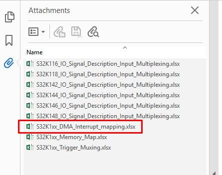

Is there available example for LPUART usage with DMA on S32K116 mcu?
The reference manual does not provide any proper documentation about how to set for example TX UART DMA...
For example where can I check the chip-specific DMAMUX information for details about the peripherals and their slot numbers?
the figure 19-2 is quite interesting but says nothing about how to map TX UART trigger to the proper dma channel... and in overall the complete dma concept is quite confiusing for me... is there an application note for S32K to how to use DMA with preiodic trigger mode on UART TX ?

I can provide you very simple LPUART TXRX DMA example for the S32K144 from my colleague Petr. (attached)
The chip-specific DMAMUX information can be found in the attachment of the Reference Manual (RM) rev.9 S32K1xx_DMA_Interrupt_mapping.xlsx
Please refer to "17.3.1 DMAMUX register descriptions" and "17.3.1.2 Channel Configuration register (CHCFG0 - CHCFG15)
The slot number (source) can be seen in the document above in the DMA_CH_MUX sheet.
Unfortunately, there is no application note how to use DMA with periodic trigger mode on UART TX. However, I believe the simple example will be very useful for you such as a starting point.
