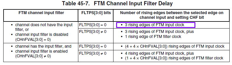

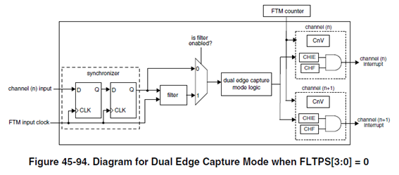

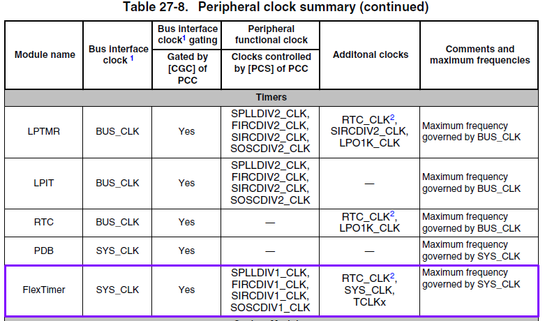

danielmartynek
Hi Rui,
The input signal is synchronized to the FTM input clock first.
The max FTM input clock frequency is given by SYS_CLK.
Then, the signal can be filtered (45.5.5.1 Filter for Input Capture Mode).
With the filter disabled, the delay is 3 rising edges of the FTM input clock.
