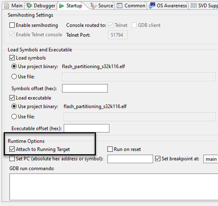

If you use a PE Micro debugger, you can attach the debugger to the running target without reprogramming the MCU.

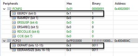

While the execution is in the loop, read these registers:
If the FlexNVM is partitioned for EEPROM and EEERDY == 1, you should see all the data preserved in the FlexRAM (EEEPROM).

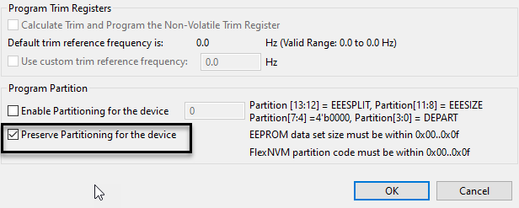

Also, you can preserve the partitioning while loading another project using the Preserve partitioning option:

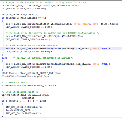

I am working on project and in that I am initializing like this.
After power on reset data getting lost.
Flashed program also getting lost. Again need to re-flash the program.

I checked for Startup -> Attach to running Target.
After selecting this option program getting stuck in ISR.

Regarding the EEPPROM, as I already mentioned, you need to check the EEERDY flag.

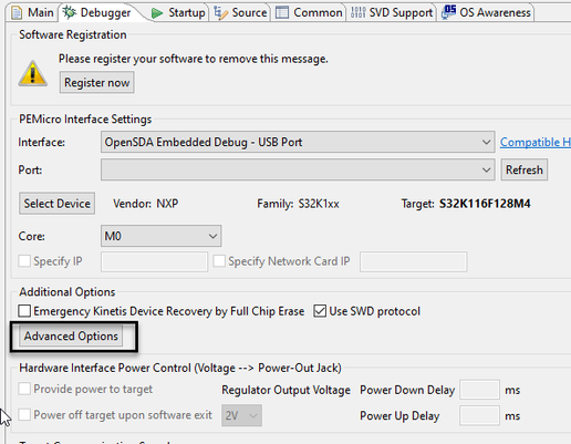

Like I am using LIN communication so LIN is working fine but after power in reset data is getting lost.
No LIN frame is able to receive and after power on reset need to re-flash the program.

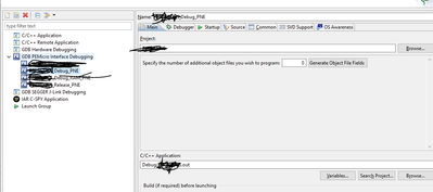

I am using option ProjName_Debug_PNE to flash the program using PE Multilink. I am using the same option for other project as well but there is  no issue.

danielmartynek
Hello @chaitanya_kalyani,
What linker file does this ProjName_Debug_PNE debug configuration use?
Because it really looks like you are loading it into SRAM.
10,243 Views
chaitanya_kalyani
Hello @danielmartynek
It is using S32K116_17_flash.icf as linker file.

danielmartynek
I have difficulties to understand the issue here.
You said that the program does not work after POR e.g. the EEPROM data are missing, LIN does not work.
There could be these reasons:
1. The code is in SRAM and it works until the MCU is power-cycled - that would explain the LIN behavior.
Please read the map file to see where the code is, make sure you load the correct image, and you can step the code and read the PC.
2. The MCU is mass-erase and re-flashed when the debugger gets connected after the POR - that would explain the missing EEPROM data.
If this is the issue, you can simply attach the debugger to the running target as it was explained already.
3. The LIN does not work because of a fault exception detected after the POR.
Please implement HardFault handler and debug it.

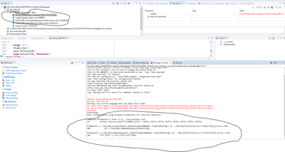

In case of while flashing giving this message
after flashing of EEPROM from underline code it is entering into DefaultISR.
In case of example it is working fine.

danielmartynek
I'm sorry but I have difficulties to understand the description of this issue.
If you have found an issue with the Design Studio, please create a new thread on the S32DS community: https://community.nxp.com/t5/S32-Design-Studio/bd-p/s32ds
Regarding the DefaultISR, this is only a default ISR for all the unimplemented interrupts.
As I mentioned in my previous post, please implement HardFault_Handler() in you project.
Also again, please read DEPART and EEERDY before you start using the EEPROM.

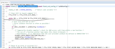

Where is the FLASH_DRV_CommandSequece() function located?
It should be in SRAM.
