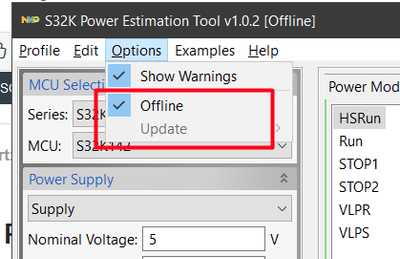

I use S32K Power Estimation Tool 1.0.2 but it has a warning:
"Unable to connect to the Update server. Please check your internet connection."
I've changed kpet.bat web address to https but my problem is not solved.

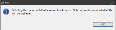

Can I download files and load them in S32K Power Estimation Tool offline?
If yes where can I download file for S32K146?
1 返信
1,644件の閲覧回数
davidtosenovjan
Hi, you must have internet connection for downloading data for given MCU. Offline mode is available as well, but it may be used only with previosuly downloaded data.
