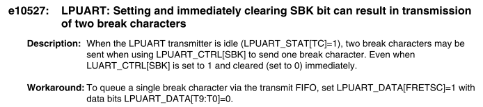

I discussed it with SW team. The only known problem is erratum e10527:
Earlier versions of SDK used LPUART_CTRL[SBK] bit but this has been fixed in release BETA 0.9.0. Which version do you use? There are no known issues in this latest version.
