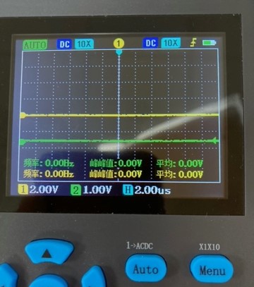

I'm trying to run the RTD example "I2s_Sai_example_S32K344", but I'm encountering a timeout issue with the I2S_SAI_RECEIVERCould you give me some advice?
HW: S32K3X4EVB-Q257
SW: S32DS 3.4 and RTD AUTOSAR 4.4 2.0.0 D2203
Pins connect:
SAI0_DATA0 - SAI1_DATA0 | P3.9 - P3.23 |
SAI0_BCLK - SAI1_BCLK    | P3.11 - P3.25 |
SAI0_SYNC - SAI1_SYNC   | P3.13 - P3.29 |
Thanks, you.

Leoken
Thank you for your reply.
I only have the S32K3X4EVB-Q257(SCH-53189 REV A), and double-check the connection is correct.
I use a handheld oscilloscope to measure the SAI0 signal. The SAI0_DATA0 doesn't send data from Transmitter (SAI0). Is this cause of the timeout? Can i fix it or not?

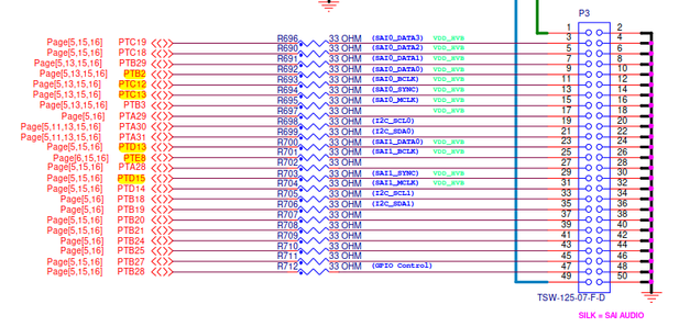

Hi @Leoken,
I don't have the SCH-53189 REV A version.
I tested it successfully on SCH-47827 REV A version.
There are some differences (like P3.21) but not the SAI signal from the example.
danielmartynek_0-1685698068576.pngdanielmartynek_0-1685698068576.pngdanielmartynek_1-1685698081862.pngdanielmartynek_1-1685698081862.png

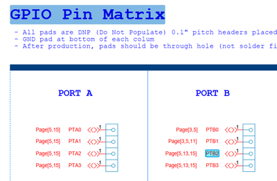

Anyway, can you test the PTB2 at J358.11 or at the GPIO Pin Matrix?
