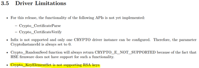

I used EB tool to configure RSA2048 key, called Crypto_KeyElementSet () to import public key, and replied to 55A5A399.
I want to know how RSA key should import public and private keys. What is the format?

Hello @cool_boy,
This is a note in the RTD_CRYPTO_UM.pdf file
I attached a RSA example, you can refer this example.
Dan
