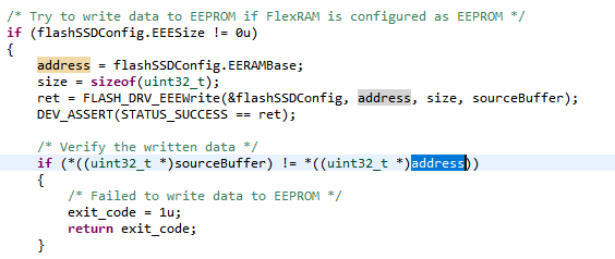

I want to write data into EEPROM and Read data from the EEPROM.
I checked flash_partitioning_s32k116 example in that it is writing the data but not getting how to read the stored data.
Can I get example to write and read the data from EEPROM.
1,627 Views
danielmartynek
The example shows how to read the EEPROM.
It can be read by a pointer to the address of the record.
uint32_t variable = *((uint32_t *)address));
