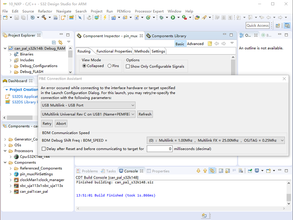

Today morning, when I debugging on S32K_148 EVB, it suddenly cannot flash&debug anymore.
I tried both "OpenSDA" and "PE micro" methods, neither is work.
I seared on the Internet and got an info the MCU might be locked, but I'm not so sure.
Also there mentioned one solve method via Jlink script, but I don't have Jlink in my side.
I only have PE Micro, could someone guide me how to detect or fix it?
I need your support. Thanks a lot.

Hello Yin,
It seems that S32 Design Studio stay on Launching progress 61%. So, at first, could you, please, try to restart the S32 Design Studio?
Also, could you please check the state of the LED D11 (is turned on or turned off)?
I hope it helps.

Hello, Diana.
Still Not ok.
After perform flash command, the LED D11 will be turned from OFF -> ON -> OFF immediately.
Then the "Not connection error" popup accordingly...

Hello Yin,
Could you, please, check updates from P&EMicro? (Help->check for updates).
Also, could you check if the MCU is not burned? (measure voltage on VDD)
Have you followed the quick start guide?
https://www.nxp.com/docs/en/quick-reference-guide/S32K148EVB-QSG.pdf
Have you tried to load an empty project?
After you click on the Retry button, the connection dialog appears again or do you see any error?
Thank you.
