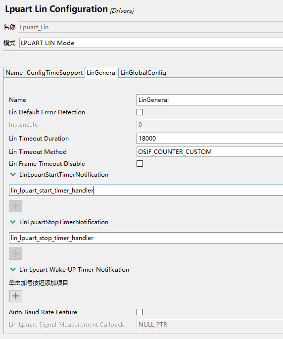

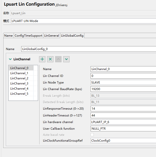

lin slave 使用定时器接收任意长度的数据,6个lin 需要使用6个定时器吗?

Hi @harryoceana,
The implementation of the timer mechanism is left to the application developer. A single continuously running timer shared across all LIN slave instances can be used.
When LinLpuart_StartTimerNotification(uint8 instance, uint32 microSeconds) is called for a LIN slave instance, capture the current timestamp.
You would need to poll periodically the timer to check if the configured timeout has elapsed for each LIN instance.
OsIf_Timer_System.h
OsIf_Timer_System_GetElapsed()
543 Views

在Lpuart_Lin_Ip.c文件里,lin的超时处理是在这个函数里完成,这要用到定时器中断的,而不是简单的设置时间戳,如果6个lin同时工作,是需要6个定时器来避免时间干扰
524 Views
danielmartynek
Hello @harryoceana,
You should call the timeout service at the end of the timeout given by the StartTimerNotification. But the implementation down to the user. The timer can be theoretically polled. But yes, using separate timers in Output Compare mode is preferable.
