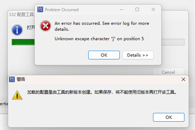

请问我截图中的这个情况是什么问题导致的?

Hi @Temple
Could you please provide more details about what changes or actions occurred just before the error appeared? Additionally, if possible, please share the log file so we can review the specifics.
Based on the error message, it seems the file may be corrupted, missing data, or formatted incorrectly due to an invalid character. To avoid further issues, please do not save the current session. As a next step, we can try checking for any incorrect characters in the configuration file or consider reinstalling S32 Design Studio to ensure a clean setup.
BR, VaneB
