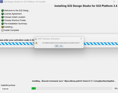

I have succeeded to install S32DS 3.6.5.
And I removed S32DS 3.6.5 to install S32DS 3.4
But I failed with Activation code error.
Please help.
[I already tried offline activation but failed. I attach the activation.xml(zip)]

petervlna
You have wrong activation key.
For S32DS 3.4. your activation key is: A6A0-FE0A-E49D-ACB8
Peter

JungkyuHan1
Thans @petervlna
I have tried to install with your code ;S32DS.3.4_b201217_win32.x86_64.exe
but nothing installed.
Here I attach the result an log file
Please take a look.

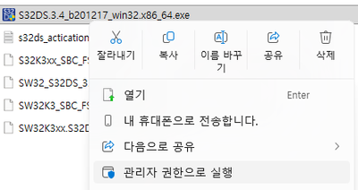

jiri_kral
please make sure, that you have full admin rights.
Also the installation path contains brackets and strange characters. Please try install S32DS into default path for test, if the custom path is an issue.

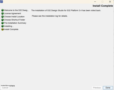

JungkyuHan1
Dear @jiri_kral
Thank you for your response
I have tried to install with Authentiatied level
And selected default directory; no space or abnormal character
But failed. [shown roll backed]
Please check the log.

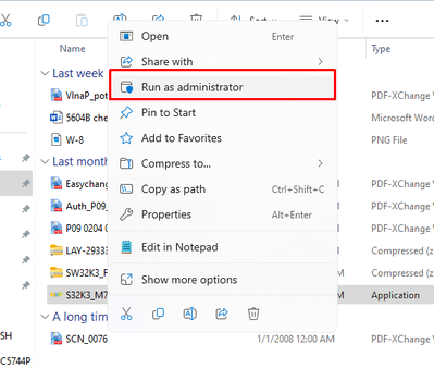

petervlna
Did you executed installation as administrator?
Otherwise for me it was rolling back the installation.
Peter
2,891件の閲覧回数
JungkyuHan1
Dear @petervlna
Yes , I Did it ; admin level

jiri_kral
I checked your account and there was only one license available for S32DS v3.4. I increased number of available licenses to default 101 licenses. Please try to install S32DS v3.4 again.
2,753件の閲覧回数
JungkyuHan1
Dear @jiri_kral
I tried again with same way but failed again with same reason.
Do I need to do something before install?
