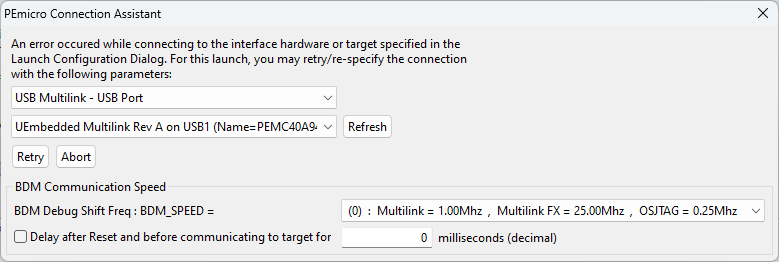

Until recently I was able to debug code normally on my development board S32K3X4EVB-T172
with S32DS. All of a sudden, when I start the debugging process, I get this message PEmicro Connection Assistant, An error occured while connectiong to the interface
I updated the extension to the latest version but it doesn't help.
This message also started appearing:
Literally everything was working normally until a few days ago....
Please help.
Thank you.

Julián_AragónM
Hi @Djuric,
I can see that LED D15 RST_OSDA is on. Also, neither D4 nor D5 are turned on.
Please check if the either power supply is connected properly, or if the voltage level is lower that the specified [+12.0V to ≥2Amps].
NXP Does not provide SW tools for erasing the memory apart from S32DS, but you can look into third party, such as PROG Flash Programming Software or J-Link Flash.

Julián_AragónM
Hi @Djuric
Sorry for the delay, does this issue also happens when a blank project is debugged? Do you have any debugging tool (PE Micro or J-link) to test the connection?
Please make sure the debug configurations are correct:
Also, if you do not have HSE enabled, make sure the flash algorithm selection in Advanced Options is set correctly.
Julián

Julián_AragónM
Hi @Djuric,
Is the reset LED turned on? Could you possibly try to use the probe on different computer?
Have you installed in the meantime some other software on your computer (e.g. Xilinx)?
P&E Drivers for Windows utilize the 3rd party service Jungo WinDriver to enable USB support under windows 10. Xilinx also uses WinDriver for their driver packages, but older versions. Starting with the P&E Driver package 11.7, a conflict between P&E Drivers and software IDES that rely on older Jungo driver packages might occur.
