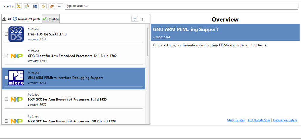

Until recently I was able to debug code normally on my development board S32K3X4EVB-T172
with S32DS. All of a sudden, when I start the debugging process, I get this message PEmicro Connection Assistant, An error occured while connectiong to the interface
I updated the extension to the latest version but it doesn't help.

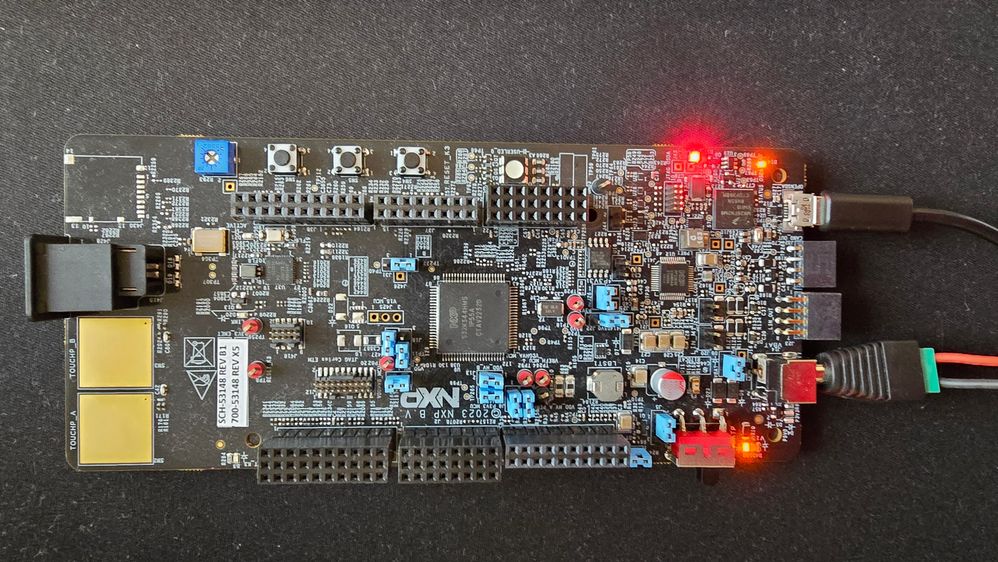

These three LEDs are on, you can see in the picture.
I tried on another computer with no success.

Julián_AragónM
Hi @Djuric,
I can see that LED D15 RST_OSDA is on. Also, neither D4 nor D5 are turned on.
Please check if the either power supply is connected properly, or if the voltage level is lower that the specified [+12.0V to ≥2Amps].
NXP Does not provide SW tools for erasing the memory apart from S32DS, but you can look into third party, such as PROG Flash Programming Software or J-Link Flash.

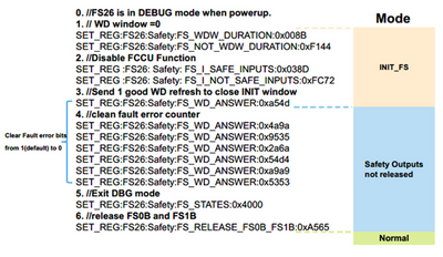

Hi @Djuric,
Below is a process for SPI commands to let FS26 enter normal mode. For your reference.

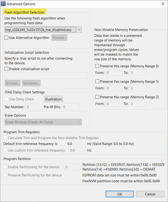

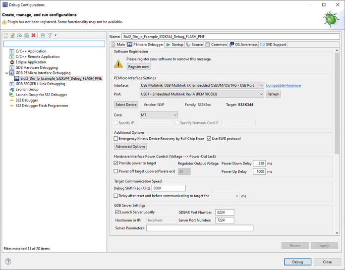

Sorry for the delay, does this issue also happens when a blank project is debugged? Do you have any debugging tool (PE Micro or J-link) to test the connection?
Please make sure the debug configurations are correct:
Also, if you do not have HSE enabled, make sure the flash algorithm selection in Advanced Options is set correctly.
