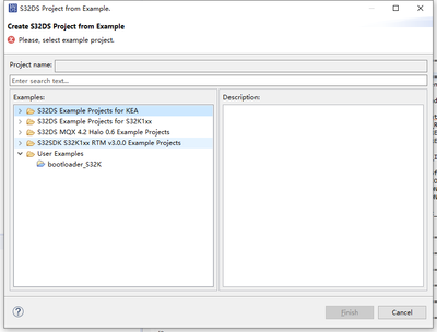

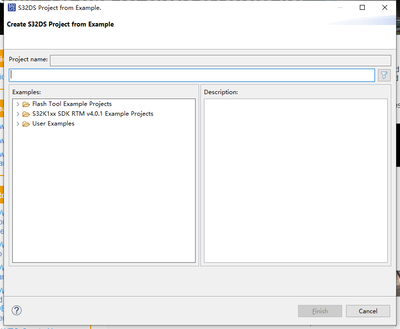

Hanoch
Thanks for your reply. Could please help me to take the next step?
I installed 'S32DS Platform V3.5', 'SW32K3_RTD_R21-11_3.0.0_P07_D2306_DS_updatesite' and 'S32DS_3.5.6_D2309'.
but still not find 'S32K3xx example'. I can only choose S32K1xx example.
What else do I install?

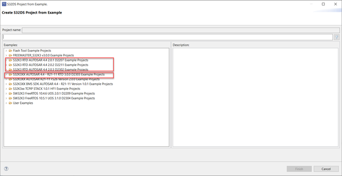

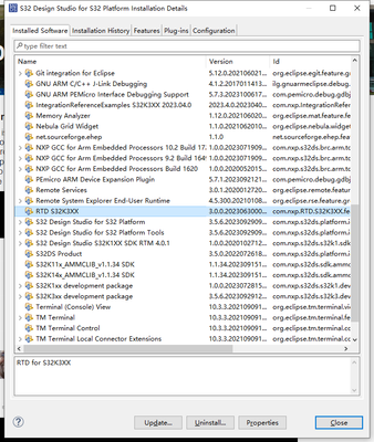

Senlent
Hi@Hanoch
below is my have installed RTD driver,you can install the highlight part driver.
