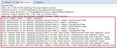

I have a question to solve the Console error while using SDK.
My project is imported.
The build is working fine while the error message is sent.
When I run SDK, the following message is sent to the Console window.
I want to solve the error below, but I don't know where to look.

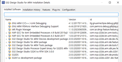

아래는 제가 사용하고 있는 버전에 대한 정보입니다.

Hello @sungjun,
I have found an SDK 3.0.0 incident report containing this very error mesage. There is an issue with the PEX code of this SDK version, but this does not effect to the configuration and generated code, please ignore it. Or use a newer version of the SDK / RTD drivers.

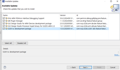

Can you give me the link address?
I pressed 'check for update' in SDK 2.2, but the RTM version is not found.

Hello @sungjun,
The Fix version filled in the report is S32K1xx_SDK_RTM_4.0.0.
However, this version uses a new configuration tool, not the Processor expert, therefore, it is not compatible with the project built with SDK 3.0.0 in S32DS 2.2 IDE.

Hello @sungjun,
I see that you have SDK 3.0.0 installed.

Hello? NXP team.
I installed RTM 3.0 to develop on SDK platform 3.4,
but due to development circumstances, I am developing by building on arm 2.2 as shown in the photo.
