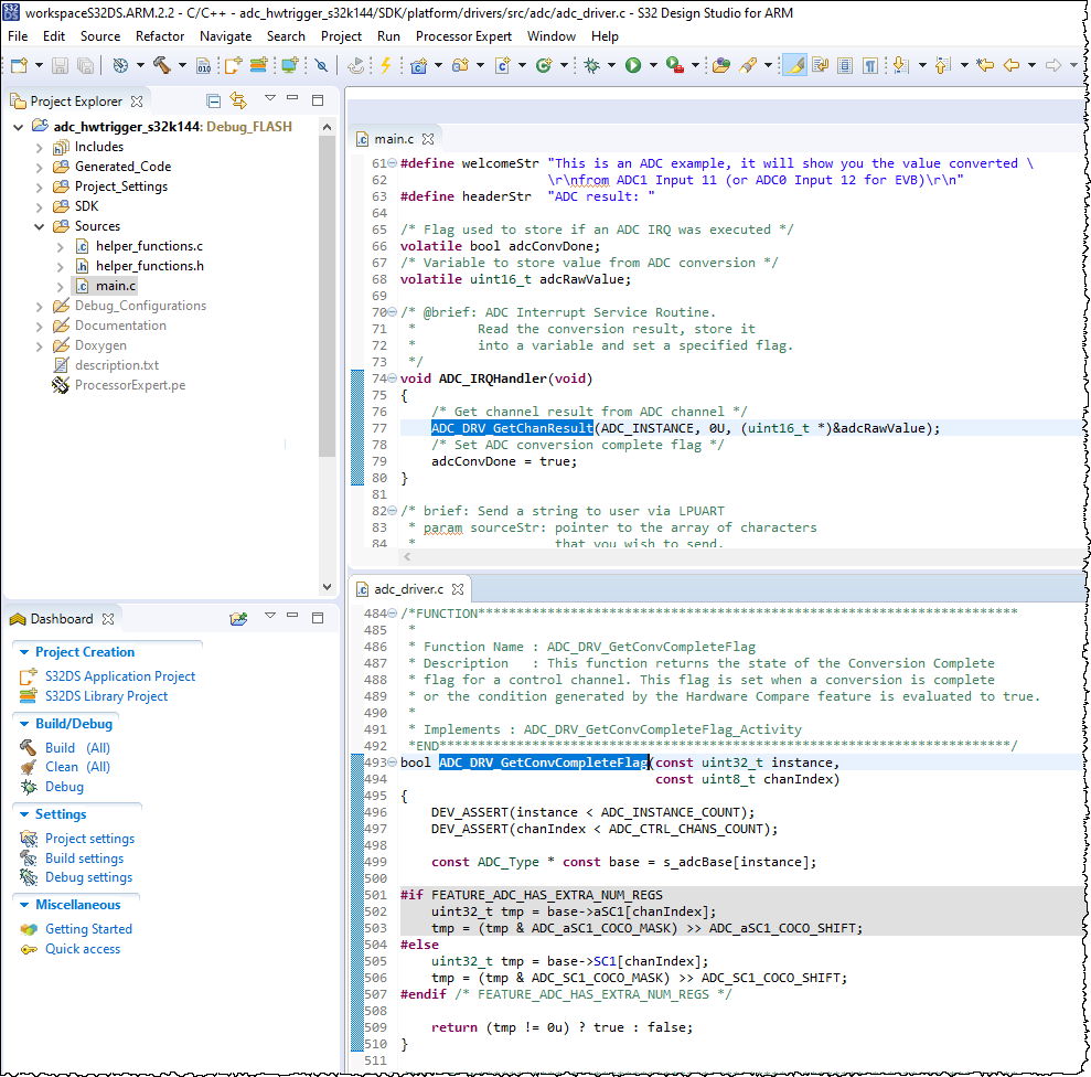

I am converting the data from the ADC0_SE12 (Pot input) using ADC and I used the while loop to continuous data read from ADC.
In S32DS I am not able to read the ADC data without breakpoint, if I add breakpoint I can able to see the change in Registers and data also coming from ADC. If I run the code without breakpoint no register update or ADC data read.
can anyone please help on this.
Thanks in advance.

When a conversion is complete, the SC1n[COCO] flag is set. You can read it with the ADC_DRV_GetConvCompleteFlag.
Your while loop call ADC_DRV_GetChanResult too frequency. The ADC may not have finished converting.
Have you refer to those ADC examples in SDK? In addition, this example is also recommended for your reference: Example S32K144 PDB ADC DMA S32DS.ARM.2018.R1

Yes you're correct. It is just to understand the ADC flow. My question is regarding the S32DS why the registers are not updating in debug mode. If I use the breakpoint the registers are updating otherwise all the register value are Zero.
