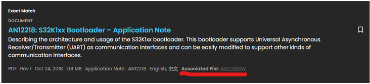

I am currently working on implementing an Over-the-Air (OTA) firmware update solution for the S32K148 microcontroller using Embedded C and S32 Design Studio (S32DS). The goal is to perform full firmware updates, with the new firmware hosted on a cloud server and downloaded over a Wi-Fi connection.
I would greatly appreciate it if anyone could share a reference project, application note, or any relevant resources that could help guide the development process.

Hi@Joseph_David
I list all the info that we have for your reference, you can serach these document and demo in www.nxp.com.
1.AN12323: S32K1xx Firmware updates – Application Note
2.AN12218: S32K1xx Bootloader – Application Note
3.AN12003: Using S32K148 FlexNVM Memory – Application Note
