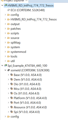

AbhishekK
Hello robin
Is there any document avaliable which guide the about EB project import and compile ,build it .
As it seems process is too much complicated .I am struggling here to import and compile it
Please help me with it
As you see project structure is too much different .

AbhishekK
Hi Robin
I got version 1 RTD package
It is Available here
5,070件の閲覧回数
AbhishekK
Hi Robin
Please let me know which RTD package is used for these plugins . as I am not able to get these Plugins
Kindly provide me path .
Abhishek

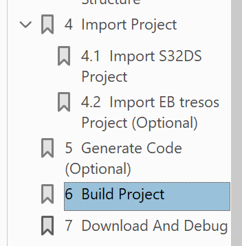

AbhishekK
Hi Robin
I have gone throught above document . In this document it is mentioned only how to generate code but I want info about Compilation of this code and elf generation .
Kindly help on it .
Here only S32ds build info is there not about EB tresos build info
5,010件の閲覧回数

Robin_Shen
I followed the following order:
5.2. Import EB tresos Project
6. Generate Code
5.1. Import S32DS Project
7.1. Build in S32DS

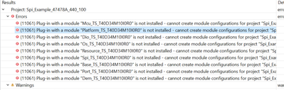

AbhishekK
 Not able to understand this Error . Can you please help me with it .
4,971件の閲覧回数
Robin_Shen
The video in the attachment records how I imported the EB project to generate code and then built the project with S32DS. I don't have S32K3 RTD 1.0.0 installed but I have RTD 1.0.0 HF01 installed. But I don't think this is the cause of this problem.
Have you tried to import the RTD 1.0.0 project and build it? (File->New->S32DS Project from Example)
If not, I'm afraid you need to raise a new question in the S32DS community and ask my colleagues for help.
