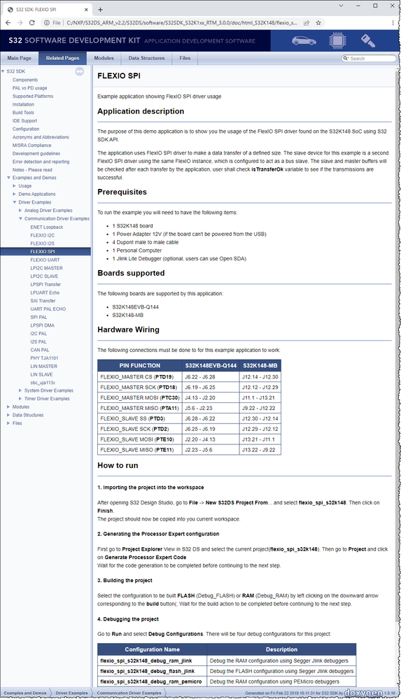

Hello NXP
I am trying the FLEXIO SPI example and i am checking the waveform on oscilloscope but i am not getting any output where should i check the output

Hi RishikeshB,
Did you follow the guide of FLEXIO SPI RTM3.0.3 flexio_spi_s32k148?(file:///C:/NXP/S32DS_ARM_v2.2/S32DS/software/S32SDK_S32K1xx_RTM_3.0.0/doc/html_S32K148/flexio_spi_s3...
Make sure Hardware Wiring, what's the value of isTransferOk after running the example?
FLEXIO SPI RTM3.0.3 flexio_spi_s32k148.pngFLEXIO SPI RTM3.0.3 flexio_spi_s32k148.png
Have you try to capture the SPI data by using logic analyzer? (It's rather strange why I can measure the waveform, but you can't. Maybe you should go to this thread and make sure the oscilloscope and S32K148EVB are working properly.)
