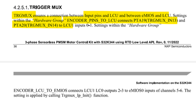

1)  can u See the Above Snippet. I have Doubt in the Icu Module, While i Configure the Icu  channels for Encoder TRAIXS_A, TRAIXS_B,TRAIXS_PWM,TRAIXS_I, for Customized board. I need to Configure the Port Pin Mode was emios_ch, EIRQ and TRGMUX_IN in these 3 which one need to select for Icu Channels for Input Direction.

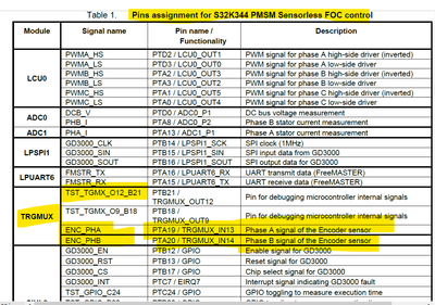

1)As for the Application TRGMUX_IN mentioned in AN13767.
2)if I Select the Emios CH[2]_IN it will work for ICU encoder.
3)if i Use SIUL2 for EIRQ[1]_IN, it support the ICU encoder. plz guide me for Which Portpin Mode In need to Select. which is More Suitable for ICU Encoder.

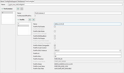

The PortPin mode for the pin that will be configured with the ICU controller should be the eMIOS channel as input. So for example, if we want to configure eMIOS 0 channel 5 with the ICU driver to count the edges of the encoder signals PHA (as mentioned in the AN13767), it should be set as input and in the PortPin configuration it should be as shown in the following image:
Please let me know if this answers your question.

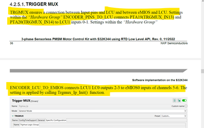

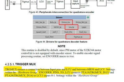

gadilinga_0-1728018807729.pnggadilinga_0-1728018807729.pnggadilinga_1-1728018902518.pnggadilinga_1-1728018902518.pnggadilinga_2-1728018955754.pnggadilinga_2-1728018955754.png
thank u For Quick Response. Plz Focus On whichever thing  Highlighted matter mentioned in AN13767 See the Pin Assignment, Trigger MUX and Quadrature encoder. Plz get to know what was the PortPin mode for  ICU Encoder.
