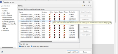

I'm still struggeling with the installation of the RTD SDK.
It seems that the installation process runs without a problem.
After the installation I see the following inventory list:
So far so good ....
But:
If I'm trying to create a new application project, there is no SDK available:
What went wrong?

maybe one additional hint:
1,232件の閲覧回数
VaneB
Hi @MarkusM25
The error message indicates that an incompatible toolchain was selected for the project, which prevents creating a project with the desired RTD version.
For RTD version 3.0.0 on S32K1 devices, the compatible toolchain is NXP GCC 10.2.0. Could you please help me verify this?
BR, VaneB

Hallo VaneB,
thank you very much for your reply. I came to the same conclusion in the meantime.
I had to install the old toolchain GCC 10.2.0. Now I can select the toolchain and now (in a
magical way) the SDK can be chosen.
