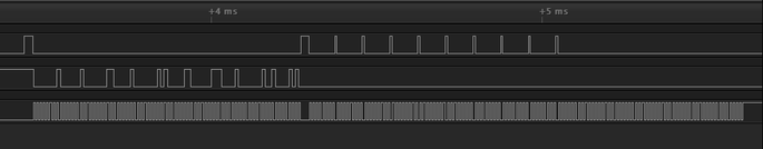

I only have to use 3 wires. I need to send and receive at MOSI pin. In the example project, I sent and received data between two SPI modules, but in my own project I cannot read data from the slave because the master does not keep the chip select pin continuous while receiving data. Why chip select did not keep continuos?
Below picture master send data (LPSPI0) and slave receive data (LPSPI1) after that receive send data and master receive. Why doesn't the pcs pin keep the pin continuous while the master is receiving data? Please review the project.

In my project, S32K148 will be master and it will communicate with TFT display, so you can think of LPSPI0 module as TFT display. I need to configure the display with 3 wire spi. Below I have attached a photo of the SPI communication specified in the datashette. Also I attached my logic analyzer screnshoot. Could you please tell me how to read data from slave correctly from master?

danielmartynek
Hi @maximillion,
I don't see any issue with the 3wire mode, but with the Continues mode.
I have created the attached simple test project (Master only).
1. CONT = 0
danielmartynek_0-1686927507069.pngdanielmartynek_0-1686927507069.pngdanielmartynek_1-1686927536911.pngdanielmartynek_1-1686927536911.png
2. CONT = 1
The issue is clearly in the Continuous mode.

danielmartynek
Hi @maximillion,
Yes, it looks like it is a bug in RTD.
Have you consider using one 80bit frame instead?
BR, Daniel

danielmartynek
Hi @maximillion,
The RTD team has found some limitations that do not allow the TXMSK CONT function in the LPSPI driver. They will update the UM with a note mentioning that.
