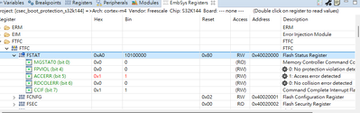

I am trying to run the csec_boot_protection example on S32K144 and encountered an issue during D-Flash partitioning.
After executing this function FLASH_DRV_DEFlashPartition();
an ACCERR error is reported, and the D-Flash partitioning fails.
Initially, I suspected that the failure might be caused by the device already being partitioned. However, I checked the DEPART register and confirmed that it is still at its default value, which indicates that D-Flash has not been partitioned yet and should be allowed to perform partitioning.
Could you please advise what might cause this ACCERR error in this scenario?
Is there any prerequisite condition, configuration, or flash state that must be met before calling FLASH_DRV_DEFlashPartition()?
Any guidance on how to properly resolve this issue would be greatly appreciated.

lukaszadrapa
Hi @WT_Liao_GARM
Yes, it looks like the device is not partitioned yet.
Do you use original example or are there any modifications?
Do you have CSEs enabled device? What is the exact part number and what is the content of SDID register in SIM module?
Lukas

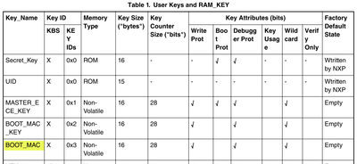

lukaszadrapa
1. Only BOOT_MAC has dedicated key slot assigned. You are not allowed to store other MACs or data to CSEc key slots.
The only option is to store the MAC to normal code flash or data flash.

1.1 When we generate the MAC for the flash region we want to verify,
where is the expected MAC stored for comparison?
  • Is it stored inside a key slot?
[NXP] Yes, there’s a slot for BOOT_MAC and it can be updated using standard memory update protocol as any other key.

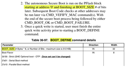

1.2 We plan to implement A/B firmware partitions, so each firmware update will produce a new MAC.
  • Can we configure the flash address range that secure boot will verify?
[NXP] The start address is hardwired to 0x0, the size is supposed to be defined by CMD_BOOT_DEFINE command.
For A/B FW partitions, there's an option to create a chain of trust. That means Autonomous secure boot is used to check the bootloader placed at address 0x0 and the bootloader then can check CMAC of application(s) using CMD_VERIFY_MAC command.
  • If the MAC is stored in a CSEc key slot, does this mean each firmware update requires writing a new MAC into that key slot?
[NXP] If flash area covered by secure boot is modified, BOOT_MAC must be update accordingly using memory update protocol.
See AN5401 for further details.
