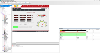

I have bought your kit MCSPTE1AK344 where I am using the microprocessor S32K344. I am using the program "S32K344_mc_pmsm_1sh_s32ct" and I have got the movement of motor. I can manage the speed of motor but I have different questions. As you can see in the next picture I have a lot of ? and I don´t know the reason (it´s is while motor is moving). Moreover, the motor sometimes don´t follow the command of speed.
Thank you for all,

I was speaking with demo kit owner.Here is the summary of the feedback:
You are stating the project "S32K344_mc_pmsm_1sh_s32ct" which is not project from official web.
Our is  MCSPTE1AK344_PMSM_FOC_1Sh_as_tr build on the EB tresos. Your project is either your port into S32DS or you get it from some unknown source.
SW can be downloaded from link below, build on RTD3.0.0.
https://www.nxp.com/design/design-center/development-boards-and-designs/MCSPTE1AK344
Here is the documentation to the examples:
https://community.nxp.com/t5/S32K-Knowledge-Base/S32K3-Motor-control-SW-examples/ta-p/1804577
Single shunt example is here:
https://community.nxp.com/t5/S32K-Knowledge-Base/S32K344-FOC-with-single-shunt-current-measurement/
We cannot comment on S32K344_mc_pmsm_1sh_s32ct. Ty to download the official SW and compare it.
 Regarding the ??? marks, these variables you do not have defined in your project and freemaster does not recognize their addresses to visualize them.
Peter

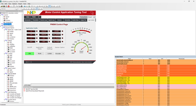

I have tried your example in S32 Design Studio and I can receive information about the MCU. In the interfaz I have the next picture and I know which the problem is. So could you help me?
Thank you

I was talking to motor control team.
the example S32K344_mc_pmsm_1sh_s32ct" is from MBDT. (model based design toolbox)
Apparently guys from NXP MDBT team has been already in contact with you.
Regarding the sceenshot you have sent it seems that you have incorrectly set jumper J18 on the K344 EVB board of devikt MCSPTE1AK344.
If you have set it for 3.3V it will sense bigger voltage.
And if you use adapter from DEVKIT for the power supply the the displayed values must be 12V.
Peter
