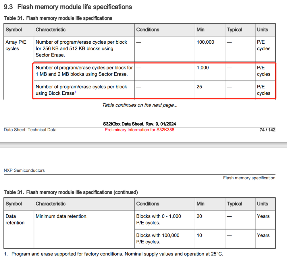

Currently, I am using the Flash module of the S32K312 chip.
According to the datasheet,  number of program/erase cycles per block using Block Erase is 25 P/E cycles.
Does this mean that if the embedded Flash is erased by blocks, it will become damaged after 25 erase/write operations?
If so, will the Flash be easily damaged during regular programming?
Furthermore, I am also confused about "Number of program/erase cycles per block for
1 MB and 2 MB blocks using Sector Erase is 1000 P/E cycles".

In the 21.7.1.2 Module Configuration (MCR) of S32K3XXRM Rev.8, you may read statement that:
Block erase is for Factory use only, under controlled conditions.
In other words, user should not use this operation at all. Also debug probed does not use this operation for MCU flash programming.
"Number of program/erase cycles per block for 1 MB and 2 MB blocks using Sector Erase is 1000 P/E cycles". This means you can erase and program the Program Flash at least 1000 times.

Hi @Robin_Shen
Thank you for your response to my post.
Your response resolved my confusion.
