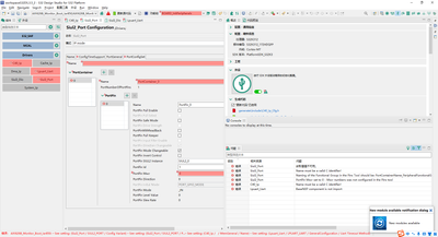

Hi, I used to develop project on RTD 2.0.3. I need to install RTD 4.0.0 on the same S32DS for a new project. But the original project mex file that base on RTD 2.0.3 can not be opened normally after the RTD 4.0.0 being installed, the module in old mex file all opened with error, I think it's a compatibility problem of RTD 4.0.0, how to solve it?

Hi@jhuang1
Please have a  try to remove the “compatibility.xml” located at “C:\NXP\S32DS.3.5\eclipse\mcu_data\configuration
This method cannot solve all version compatibility issues.
You need to install a separate IDE for each RTD version.
