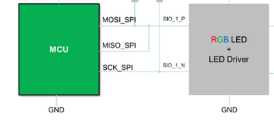

Hello.
As I understand it, ISELED connects the MOSI and MISO lines of SPI together into a single line, SIO_P.
In the ISELED Strip configuration, only one data pin can be selected.
Which line should I select between MOSI and MISO?

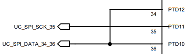

On my PCB, pins PTD10 and PTD12 are tied together for output.
Which pin should I select as the ISELED strip data pin?
