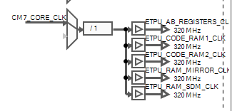

Hi, @Nhi_Nguyen,
While testing, I have noticed another behavior of the QSPI module which might help. I have noticed that, if I restart the board by turning the power supply off and then back on, run the modified example with sys_init() and then run the same modified example with MCU_Init(), I get the correct WRR instruction sent (CASE 2 from 1_board_restart_behavior.png). If I restart the board and run the same modified example with MCU_Init(), the WRR instruction is no longer sent correctly (CASE 3 from 1_board_restart_behavior.png). Do you think there might be another setting/register (besides the QSPI, FXOSC, FIRC and SIRC ones) which could impact the write register operation?
Also, please let me know if you find anything on your board.

Thank you for your support! After our discussion, it seems that the most probable cause is a bug in the generated MCU driver, namely MUX_10_DC_0. We have requested a hotfix for this.
68,280 Views
Hi, @Nhi_Nguyen ,
I have tried to modify manually the value which sets the MC_CGM/MUX_10_DC_0 to the same value as the one obtained with sys_init() (0x80020000) for PLL PHI1 at 240 MHz (1_DIV3.png), but the WRR instruction is still not sent correctly. I have also tried something similar with PLL PHI1 at 320 MHz, but still no luck.
Do you think there might be something else which corrupts this instruction?

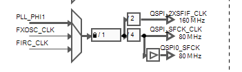

Nhi_Nguyen
Hi @maria_beatrice_balaceanu ,
I've just realized that a part of divider of MUX_10_DC done default by HW, so, we don't need to plus it to MUX_10_DC_DIV. So, it is not bug in driver. So, can you please cancel request to hotfix.
Just follow RM with option A+ memory

Hi, @Nhi_Nguyen,
Thank you! I confirm that the WRR instruction is sent correctly with this configuration (RM 23.7.2.1 with Option A+). We have cancelled the hotfix request.
I have also tried to decrease the frequencies of the CORE_CLK and CM7_CORE_CLK clocks, while keeping the other frequencies the same as in RM 23.7.2.1 with Option A+, but then the WRR instruction is no longer sent correctly. Is RM 23.7.2.1 with Option A+ the only clock configuration for which the QSPI_IP_OP_TYPE_WRITE_REG operation sends the correct data?

Nhi_Nguyen
I don't think so. Because follow to RM for S32K396, have 2 clock options that support QuadSPI:
You can try to configure option B as below:
Nhi_Nguyen_0-1688096679743.pngNhi_Nguyen_0-1688096679743.pngNhi_Nguyen_1-1688096689240.pngNhi_Nguyen_1-1688096689240.pngNhi_Nguyen_2-1688096698166.pngNhi_Nguyen_2-1688096698166.png
In configuration:
Nhi_Nguyen_3-1688096750914.pngNhi_Nguyen_3-1688096750914.pngNhi_Nguyen_4-1688096758499.pngNhi_Nguyen_4-1688096758499.pngNhi_Nguyen_5-1688096811578.pngNhi_Nguyen_5-1688096811578.png
