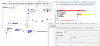

Nhi_Nguyen
Hi @maria_beatrice_balaceanu ,
For PLLFM->SPREADCTL you can select it as below:
For PLL Calibration Register 2 (PLLCAL2):

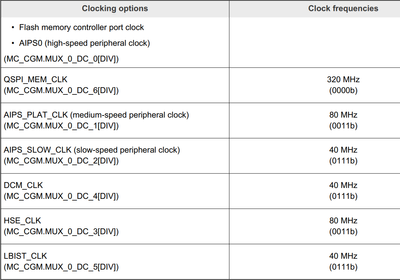

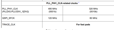

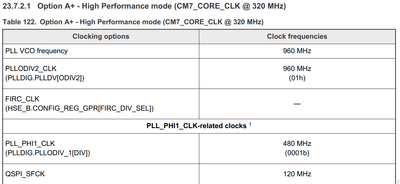

Nhi_Nguyen
I've just realized that a part of divider of MUX_10_DC done default by HW, so, we don't need to plus it to MUX_10_DC_DIV. So, it is not bug in driver. So, can you please cancel request to hotfix.
Just follow RM with option A+ memory
Hi, @Nhi_Nguyen,
Thank you! I confirm that the WRR instruction is sent correctly with this configuration (RM 23.7.2.1 with Option A+). We have cancelled the hotfix request.
I have also tried to decrease the frequencies of the CORE_CLK and CM7_CORE_CLK clocks, while keeping the other frequencies the same as in RM 23.7.2.1 with Option A+, but then the WRR instruction is no longer sent correctly. Is RM 23.7.2.1 with Option A+ the only clock configuration for which the QSPI_IP_OP_TYPE_WRITE_REG operation sends the correct data?

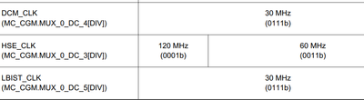

Nhi_Nguyen
I don't think so. Because follow to RM for S32K396, have 2 clock options that support QuadSPI:
You can try to configure option B as below:
Nhi_Nguyen_0-1688096679743.pngNhi_Nguyen_0-1688096679743.pngNhi_Nguyen_1-1688096689240.pngNhi_Nguyen_1-1688096689240.pngNhi_Nguyen_2-1688096698166.pngNhi_Nguyen_2-1688096698166.png
In configuration:
Nhi_Nguyen_3-1688096750914.pngNhi_Nguyen_3-1688096750914.pngNhi_Nguyen_4-1688096758499.pngNhi_Nguyen_4-1688096758499.pngNhi_Nguyen_5-1688096811578.pngNhi_Nguyen_5-1688096811578.png
