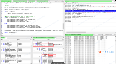

Hi:
    There is a HardFault error when I call interface HSE_ProgramAdkp() to set ADKP password, but there is no response, when stop, there is an HardFault error, the pHseSrvDesc and pAttr(debug key password) are all in on-cache, shows below:

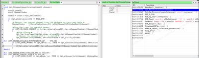

from CFSR, it seems that there is a BussFault error in call  (*(Gpt_pConfig[coreID]->Gpt_pChannelConfig))[ChannelIndex].Gpt_pfNotification();
but I think the address is correct, so why does this happend?
Because program ADKP is irreversible, that means I can only do this once in one board?

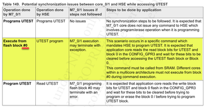

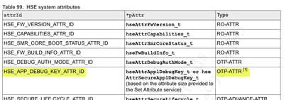

ADKP is stored in UTEST:

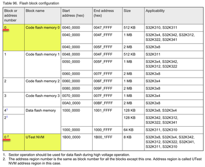

But UTEST is in the same partition like code block 0:
So, it's necessary to take care about the synchronization as described in HSE FW RM:
And yes, ADKP is one time programmable only.
Lukas
