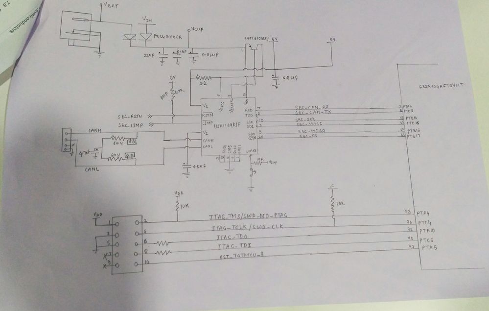

ssingh
This is UJA1169TK/F connected to S32K.S32K is supplied power by USB. I have connected 120 ohms termination resistor between CANH and CANL. The positive terminal of the battery is connected to VBAT and negative is connected to ground. Since both UJA1169 and S32K are working at 5V, all signal pins are directly connected to corresponding S32K pins. Still, I am not getting any signal. Please help me out. What is wrong with this circuit?

ssingh
This is the circuit, I had uploaded earlier which you were not to able see. Now, we are getting output at pin V1 but it falls from 5V to 0V slowly. The output is constant at 5V. How to clamp V1 at 5V? What could be done to solve this?

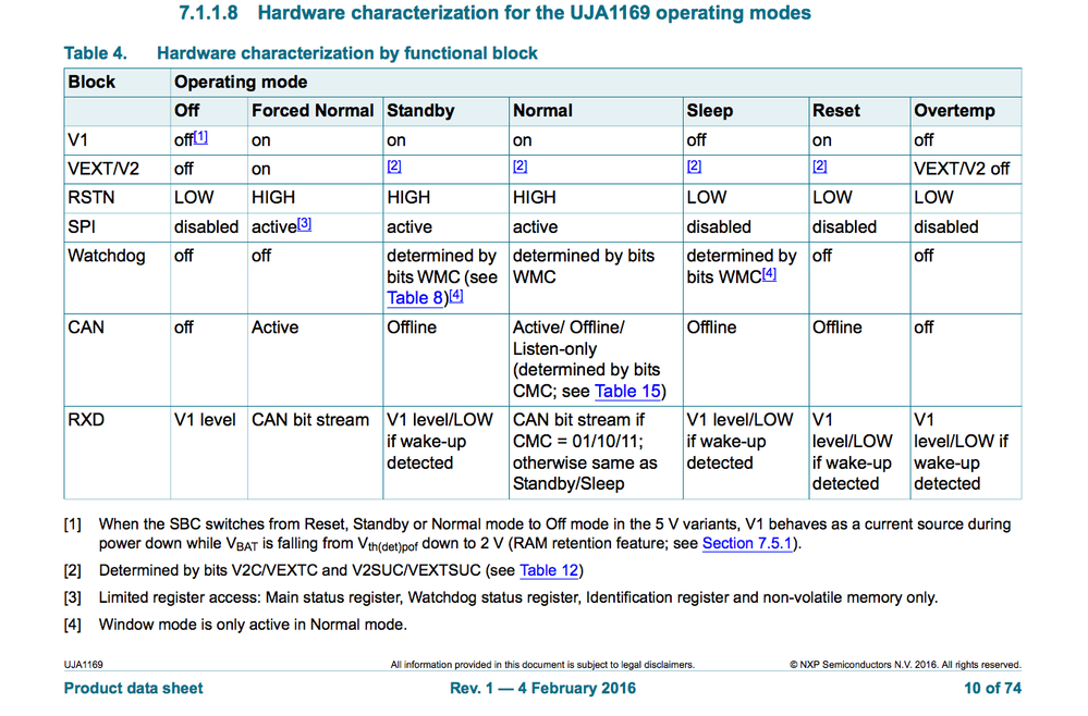

brady_nxp_cui

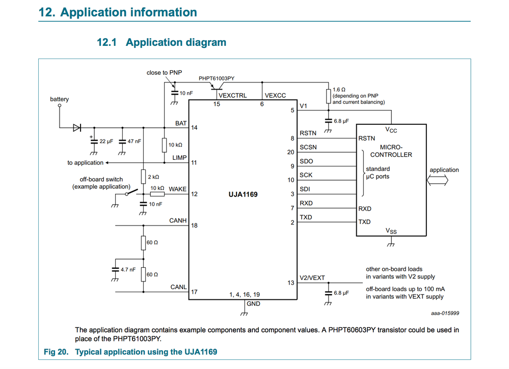

yuganshbansal
Hello Cui,
Just to fill you in. Me and Shreya are part of a same team working for an automotive company. We are using S32k Micro-controller (S32K144EVB) as part of our embedded system. Now we are making our own custom PCB using FS32K144HFT0VLLT MCU and UJA1169. Now my micro-controller can be successfully programmed, although when i make connections of this MCU to my UJA1169 as shown in the datasheet (page 64), somehow i am not able to receive data on my computer. Like Shreya said, V1 doesn't show any output and V2 gives me 6Volts. I have tried this with plenty of UJA1169 IC's and getting the same result. So, i am sure my IC is soldered just fine on the breakout board. What possible reasons could you suggest me ? I'd really appreciate your expertise.

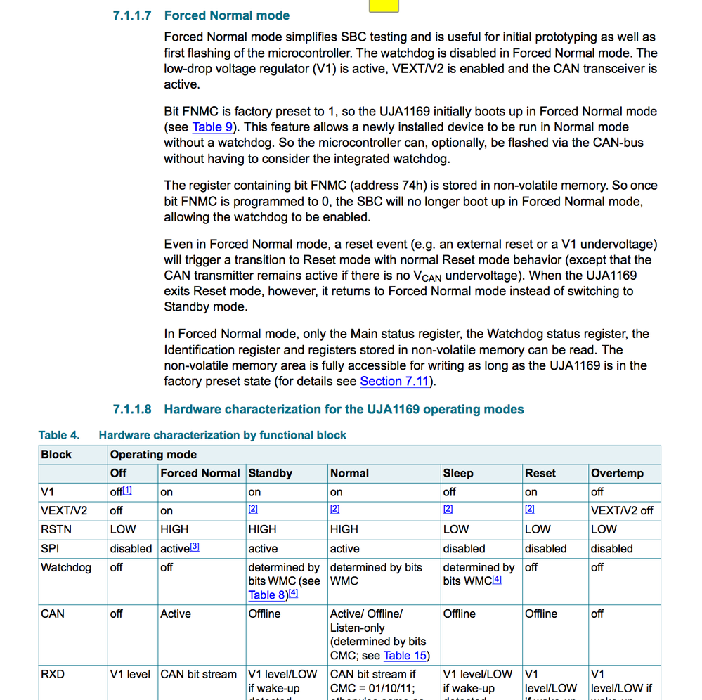

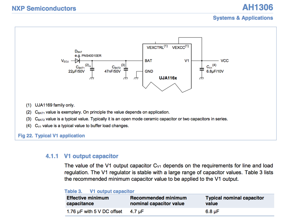

brady_nxp_cui
can you show me the schematic about UJA1169?   Do you used an external PNP?
If you don't use an external pnp,I think you should connect Vexcc pin and V1 pin. and connect a capacitor to ground.
please see picture from AN1306.
I think the hardware design should be checked before the V1 is correctly output.
In general, if it is a new chip, V1 should have a 5V output after power-on.bacause it should at "forced normal mode" you can find it at datasheet page10.

yuganshbansal
Thank you for your response. I am not using PNP transistor in my schematic and the rest of the application diagram is same as shown on the page 64 of datasheet.
I have tried connecting PNP as well but haven't got any result therefore i am not connecting it now. Should it be important to connect the PNP ?

ssingh
Ok, I will do that.I am attaching the complete circuit. Is everything correct?
UJA1169K/F CIRCUIT
