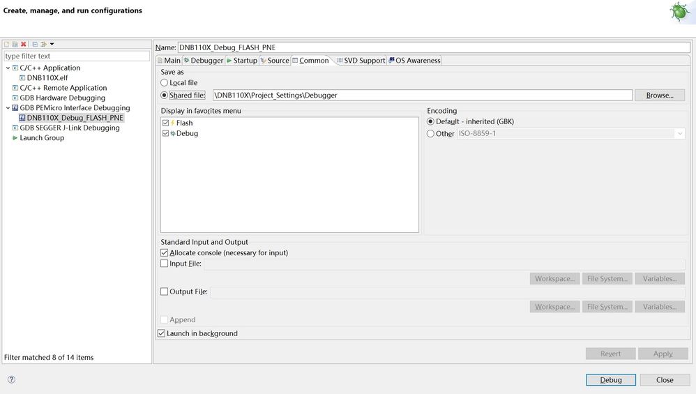

Senlent

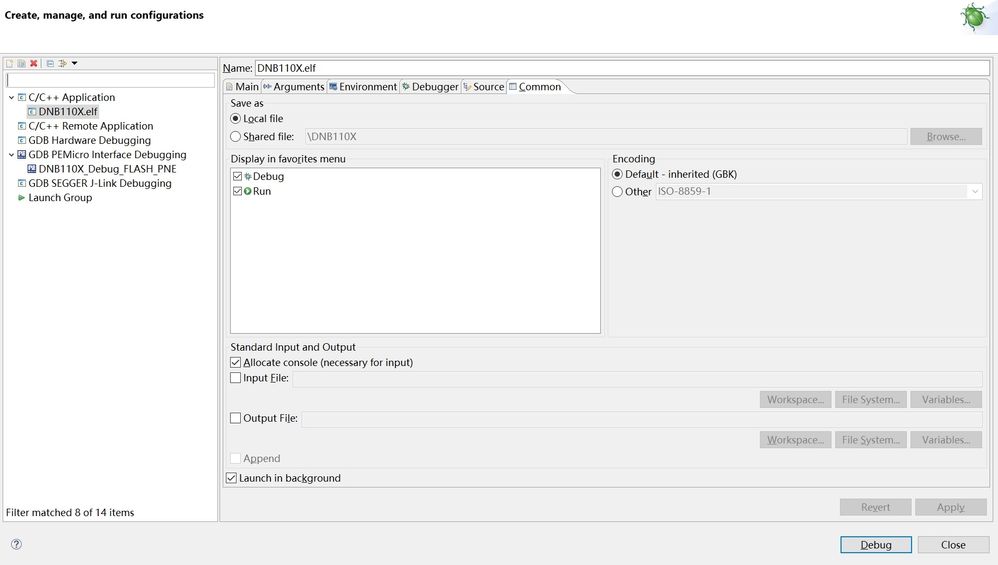

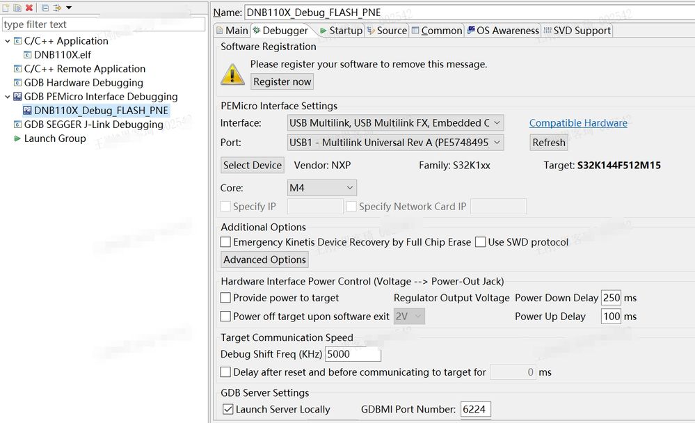

Hi@muggle
Could you please show us your Debug Configurations?

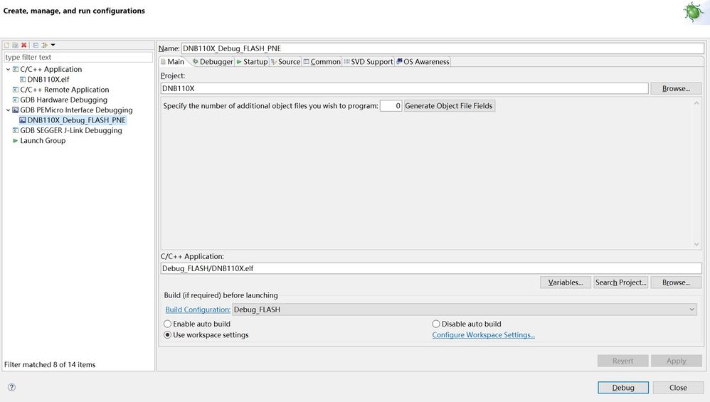

Senlent

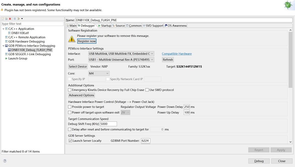

Hi@muggle
Can you provide a screenshot of the entire configuration page?

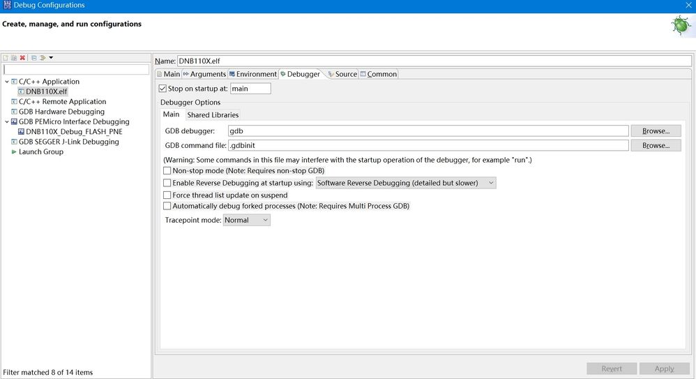

It looks like you didn't start GDB but the elf file

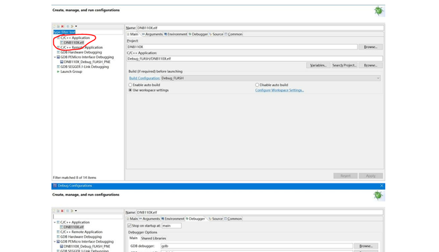

Senlent

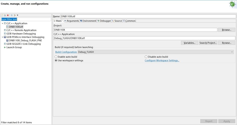

Hi@muggle
There is no need to Configurate "C/C++ Application"

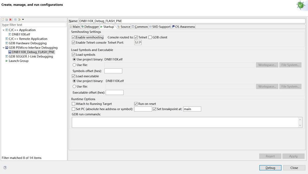

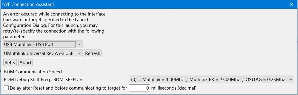

Senlent
Hi@muggle
This prompt is very clear, no link detected
Are you using S32K144EVB? What debugger are you using?

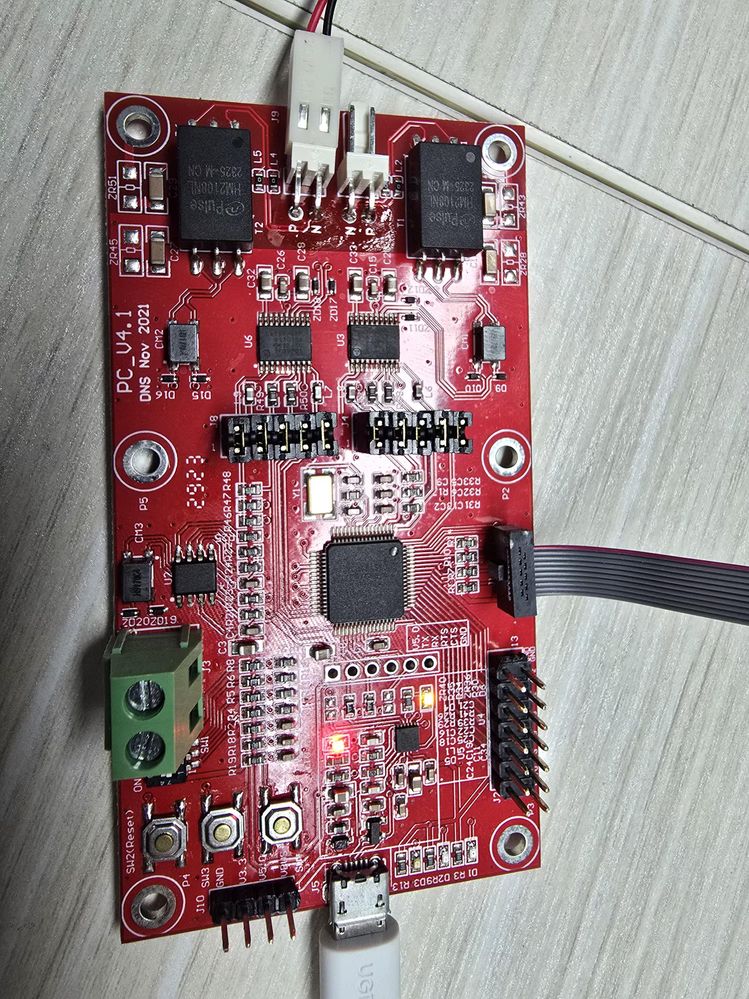

Senlent
Hi@muggle
电脑显示你的PE应该是链接了,但是到MCU的链接没有正确,你确定你的调试器到MCU的连接是不是正确的,用J-LINK吗,可以用J-LINK也试一下。打开S32 DS提供的例程,直接编译烧写一个试一下。

Senlent
Hi@muggle
你确认下你的调试接口是不是正确,是SW口吗,你用的调试器是什么?是PE还是什么

muggle
JTAG,我是使用的是PE Multilink Universal Rev A
