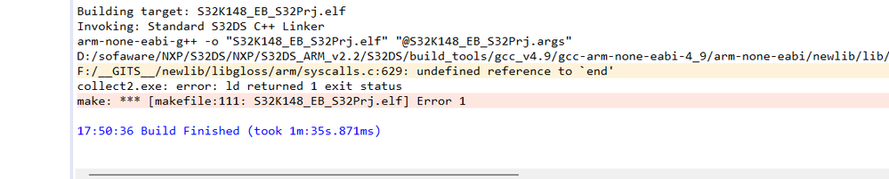

    I want to use the printf function on the console to print some information while debugging on the S32 Design Studio IDE.
    But what do I do when I re-select the library and the following error occurs when I compile?
    Platform:S32 Design Studio for ARM Version 2.2

Hi @Embedded_novice
You need to use lib C with Debugger console:
The printf output is shown in the Semihosting console.

I have tried.
I am not the one who created this project. I wonder if there is any way to adapt C++ to C if C++ and C do not share certain parts of this library.

Hi @Embedded_novice
C++ and C have specific differences between them. If you plan to adapt your project, we recommend you investigate these differences first.
