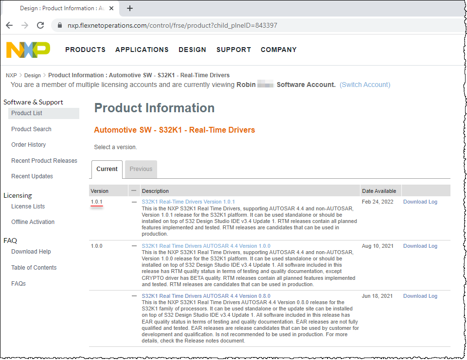

Robin_Shen
Please download the latest Real-Time Drivers for S32K1
Automotive SW - S32K1 - Real-Time Drivers.pngAutomotive SW - S32K1 - Real-Time Drivers.png

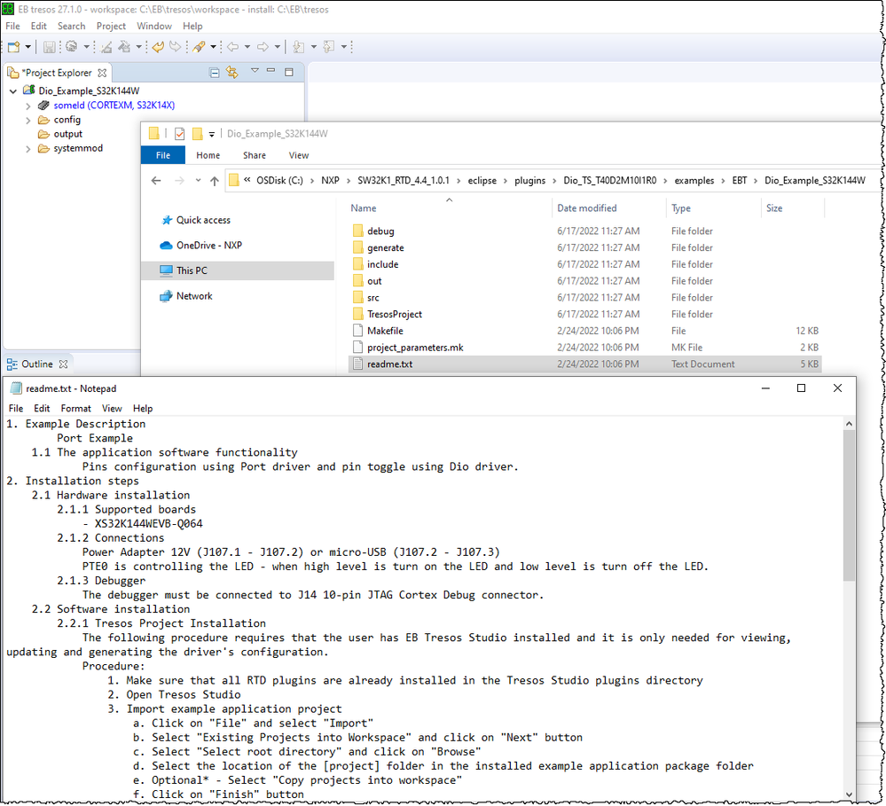

Then you will find the Dio_Example_S32K144W (C:\NXP\SW32K1_RTD_4.4_1.0.1\eclipse\plugins\Dio_TS_T40D2M10I1R0\examples\EBT\Dio_Example_S32K144W)
The schematic of S32K14WEVB-Q064 can be found in S32K144W Evaluation Board Design Files. (...\S32K14WEVB-Q064-DESIGN-FILES\SCH-S32K14WEVB-Q064)
