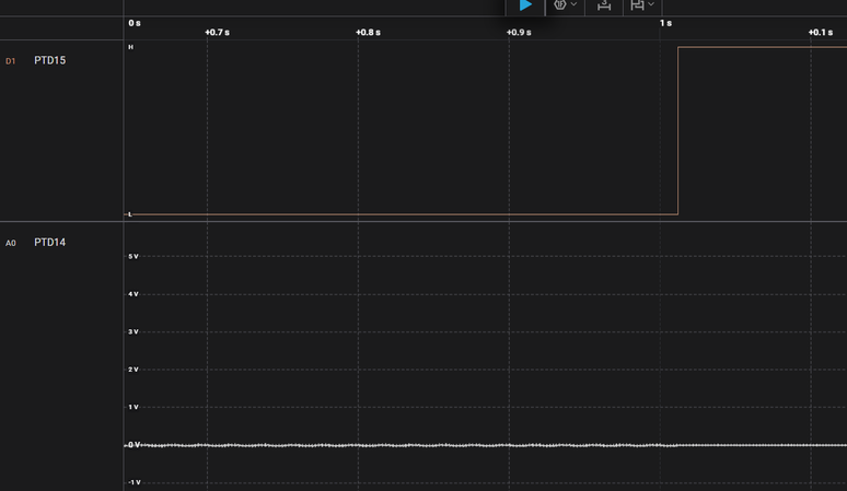

Hello @ManuSharma,
I'm not able to reproduce it on S32K312 EVB.
	IP_SIUL2->GPDO110 = 0;  /* PTD14 */
	IP_SIUL2->GPDO111 = 1;  /* PTD15 */
	IP_SIUL2->GPDO113 = 0;  /* PTD17 */
	IP_SIUL2->MSCR[110] = 0x00280000;
	IP_SIUL2->MSCR[111] = 0x00280000;
	IP_SIUL2->MSCR[113] = 0x00280000;
    for(;;)
I see PTD15 is driven high, whole PTD14 stays low (analog signal)
It looks to me like the spike to bias voltage during power up.
The spike follows VDD until the MCU becomes biased at ~0.7V.
Can you measure VDD along with the pins?

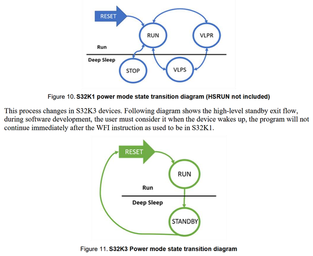

We have observed additional behavior related to pin state spikes in various scenarios, particularly when waking up from Low Power Mode. Please find the details below:
Steps Followed:
1. Set the output value of the pin to LOW.
2. Entered Low Power Mode (Sleep/Standby).
3. Triggered wakeup from low power mode.
4. Observed a brief spike (HIGH) on the pins before they returned to LOW.

1,763 Views
danielmartynek
Hello @ManuSharma,
Even without PadKeeping enabled, the MCU retains output states during Standby mode.
However, the purpose of PadKeeping is to ensure that the state of the pins is preserved across the wake-up reset - not just during Standby, but also through the transition back to RUN mode.
The "PortPin Pull Keeper" option enables PadKeeping locally for individual pads.
PadKeeping must also be enabled globally in the MCU driver for Standby mode (DCM.DCMRWF1[STANDBY_IO_CONFIG] == 0)
After Wake-Up Reset:
Reconfigure the pins from their default reset state to the configuration they had before entering Standby mode (via the PORT driver).
After that, disable PadKeeping globally in the MCU driver (power mode configuration).
This sequence ensures that the pins retain their intended state throughout the entire low-power cycle.
1. Yes
2. Yes, the MCU goes through a system reset.
3. No
1,757 Views

1,727 Views
danielmartynek
Hi @ManuSharma,
The transition from STANDBY to RUN is always through a system reset.
Yes, the MCU performs it on it own.
https://www.nxp.com/docs/en/application-note/AN13414.pdf
