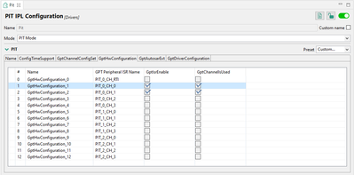

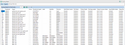

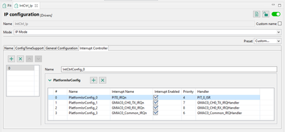

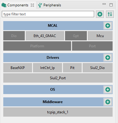

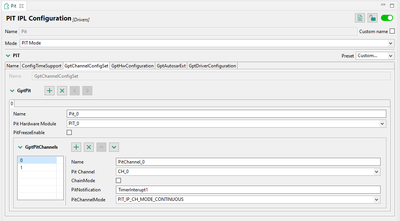

The configuration in PINtool is as follows:
The configuration in the peripheral tool:
ajosep12_2-1737356711208.pngajosep12_2-1737356711208.pngajosep12_3-1737356734330.pngajosep12_3-1737356734330.pngajosep12_4-1737356761254.pngajosep12_4-1737356761254.png
I have also set breakpoints insider the TimerInterupt1(); function, which is supposed to be called every 50 ms, but the execution never reaches the breakpoint.
Is there anything that I'm missing?
I compared with the available Pit_Gpt_Ip_example as well, but couldn't find why the modifications that I made to TCPIP example isn't working with respect to the timer interrupts, while the rest of the functionality of the TCPIP example works perfectly.
