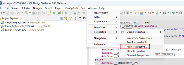

In my S32 design studio (3.6.0) app, I am unable to access the Peripherals section in toolbar. ishoboiM_0-1748585813418.pngishoboiM_0-1748585813418.png
I have tried messing with the toolbar up to no avail even in the search option and Open perspective, peripherals is shown but I am not directed anywhere near the peripherals tab except this screen
Can you please provide help with this? Thank you

petervlna
Try resetting perspective.
Peter

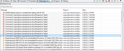

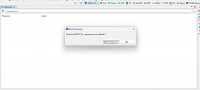

As you have told me I have tried resetting perspective But it always resets the perspective before i open peripherals, For example if i opened clocks perspective before peripheral perspective and click reset, It resets the clock perspective, and if i close every perspective before opening peripherals and click reset, It asks for me to rest S32DS C/C++ perspective,
Moreover in the error log it is displaying this

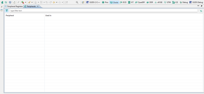

ishoboiM
Hello Peter,
I have tried closing all perspectives and then opened peripherals, it seems to be working as it had showed up
If any issue persists, I will go for the reinstall
