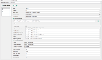

I am currently designing an ADC reading system where I trigger the BCTU using PWM flags in OPWMT mode. I have set up three triggers for the BCTU, each offset to ensure that signals are sampled sequentially and stored in the FIFO in the correct order. This way, I can be certain that the data in FIFO[0] corresponds to the first signal, FIFO[1] to the second signal, and FIFO[2] to the third signal.
The setup is as follows:
  • PWM Trigger CH3 —> BCTU —> ADC 0
  • PWM Trigger CH1 —> BCTU —> ADC 1
  • PWM Trigger CH2 —> BCTU —> ADC 2
I have designed my ADC reading system as described, but the signals are not appearing in the correct order. Could you please assist me with this issue? I have attached my project.

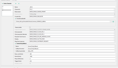

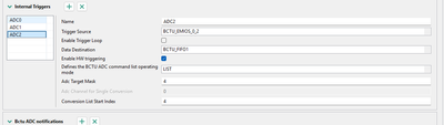

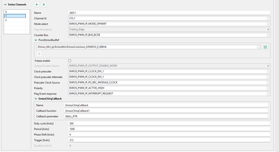

Consider the example that I sent you (all in OPWMT mode):
EMIOS_0_3 has an offset value of 1
EMIOS_0_1 has an offset of 312
EMIOS_0_2 has an offset of 416

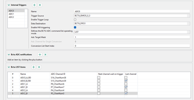

Here is my BCTU configuration
Ayaz_3-1733912296640.pngAyaz_3-1733912296640.pngAyaz_4-1733912307270.pngAyaz_4-1733912307270.pngAyaz_5-1733912317463.pngAyaz_5-1733912317463.png

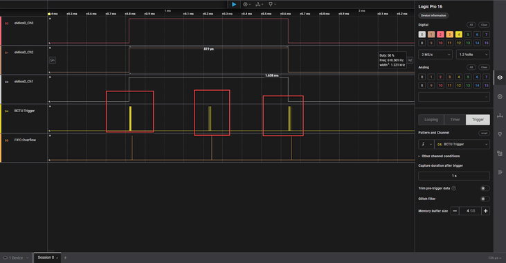

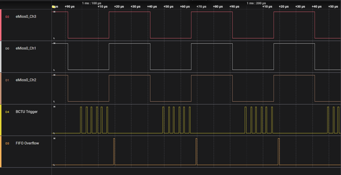

When I plotted the eMIOS trigger I can see the trigger offset on the oscilloscope.
Considering that the BCTU FIFO is empty at the start, I expect that the EMIOS_0_3 will be the first to generate a trigger to the BCTU. The signals ADC0_A_RD and ADC0_B_RD will be sampled first and will be filled in the BCTU FIFO[0] and BCTU FIFO[1].
The next trigger will be EMIOS_0_1 and will sample the signals ADC1_A and ADC1_B. These 2 values will be stored in the BCTU FIFO[2] and BCTU FIFO[3] respectively.
Finally the last trigger EMIOS_0_2 which will sample ADC2_A and ADC2_B and store it in BCTU FIFO[2] and BCTU FIFO[3] respectively.

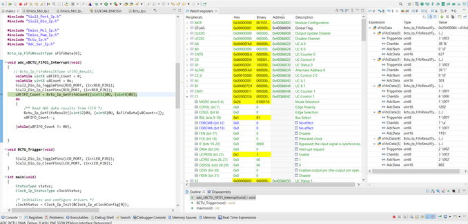

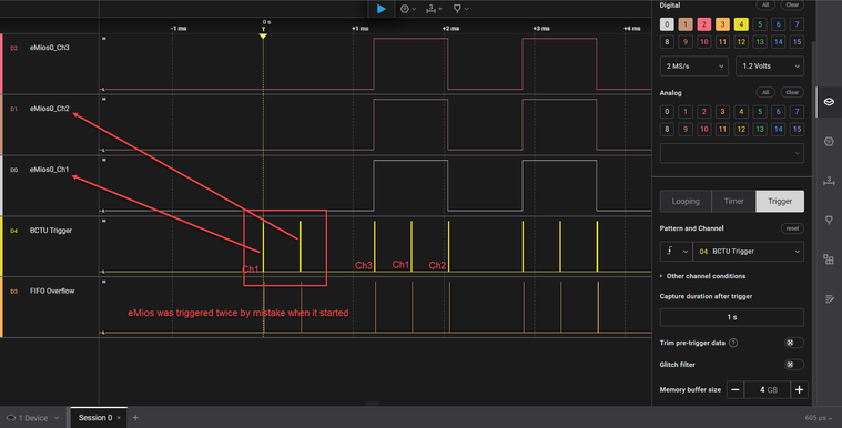

But when I read the first 6 BCTU FIFO values using Bctu_Ip_GetFifoResult API I see the following order
This is not as per the expectation. Could you help me with what is going wrong?
P.S.: The sample time for all the ADC's are the same.

Hi@Ayaz
This is probably because the interval between your emios triggering BCTU is too short, causing a timing error. You can increase the trigger interval and try again.

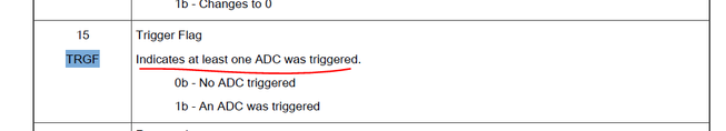

1.Would the 'BCTU Trigger' be triggered every time the ADC is triggered by the BCTU (BCTU output trigger) or the eMIOS triggers the BCTU (BCTU input trigger)?
According to the BCTU MCR->TRGF register,it should be the fisrt one which is BCTU output trigger to ADC.

In short, there is no problem with your project and your's understanding is right.
I modified your demo and tested it.(Please refer to the attachments)
The incorrect data order in the FIFO may be caused by the following reasons.
You will find that this is because there are some problems in the first cycle of PWM, which leads to inconsistent FIFO storage order.
I modified the trigger points of OPWMT to Ch3, Ch1, Ch2, the watermask value is 3, and the sampling is 4 times each time the trigger is triggered, for a total of 12 samples.
3,514 Views

2) for OPMMT mode , to calculate the offset .
Offset in ticks = core clock * time (us) . But the trigger start from 1 .
My question is is the the formula above should be +1 or -1 ??
